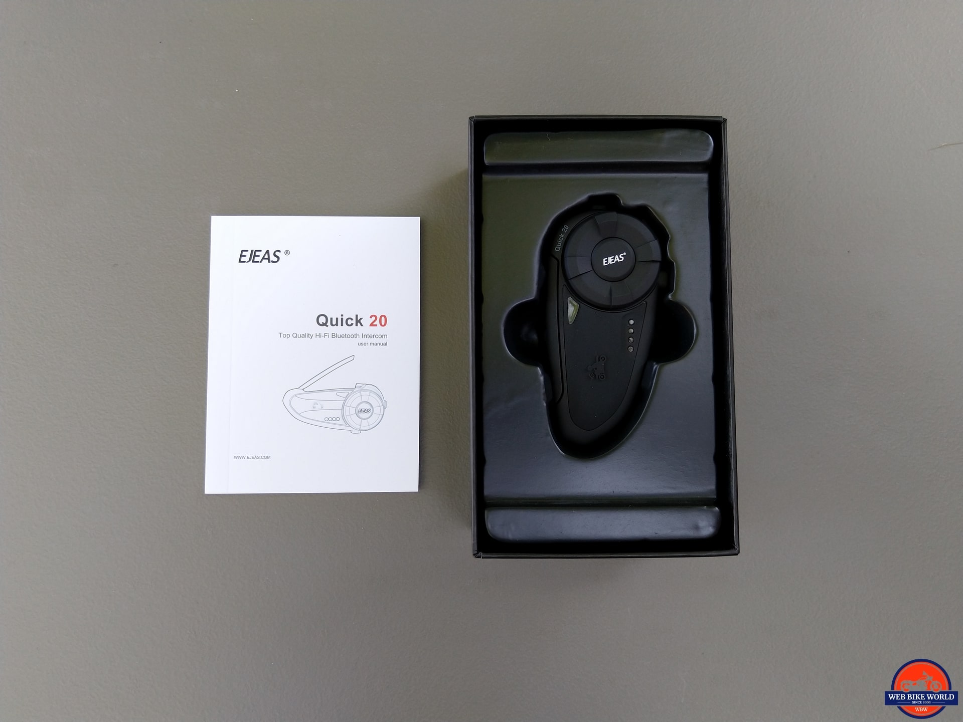

The EJEAS Quick 20 retail box kit is basic but everything needed is provided including extra mounting fasteners for the small mounting clip that is likely to be the preferred low-profile installation option.
Contents
- Quick 20 BT Module
- Headset harness with stereo speakers, microphone lead on modular connector leads, & 3.5mm connection jack
- Thin wire & boom microphones
- Micro-USB to USB A charging/data cable
- Two foam speaker covers
- Multi-piece bag of mounting rounds
- Large & small plate mounts (& related adhesive pieces)
- Quick 20 pocket User Manual (multi-language)

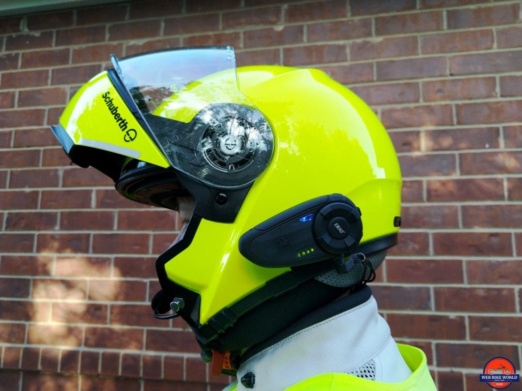

Schuberth C3 Pro
For the Schuberth C3 Pro, there’s nothing complicated here, less having to cope with a boom microphone when closing/opening this uber-quiet versatile modular helmet. The speakers fit nicely into the slightly angled elongated speaker recesses that allow precise speaker and ear alignment.
It didn’t take much longer to layout and secure the boom microphone component to previously installed hook-n-loop pieces that sit along the bottom of the EPS liner and are totally hidden once the liner sections are snapped back into place.
As is the norm for this helmet, the headset connector harness runs out from the back edge of the neck collar and then forward a bit so the 3.5mm jack connects to the module that sits securely in place on the small adhesive plate mount that is positioned behind the plastic edge for the sun-visor control. Low profile, no-conflicts, all good.
